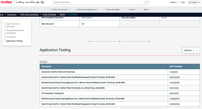

This information can be found by looking up the crimp part number in our datasheet on the molex website. Below is the link to the crimp part.
https://www.molex.com/en-us/products/part-detail/500798000
You can then click “application tooling” and it will list tools that apply to that crimp.
You want the hand crimp tool, there are two options, one for 32-36AWG and the other for 28-26AWG. Pick the one that matches the AWG of the wires you use.
