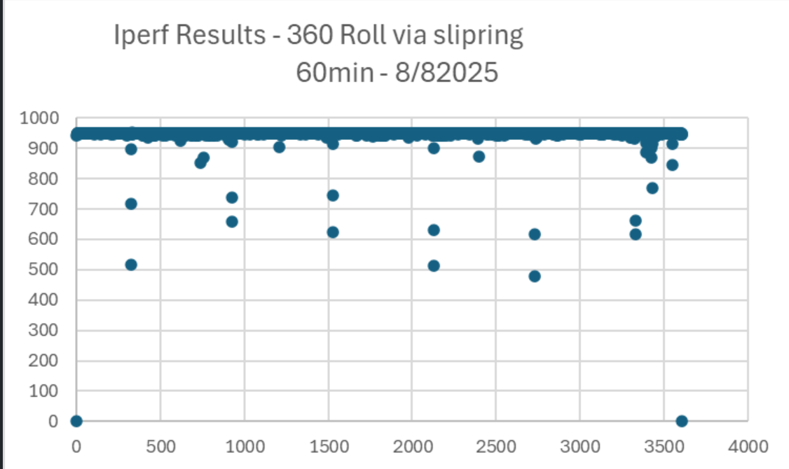

We have completed some initial testing with the SPEBlox over a slip ring and are generally impressed with the reliability and bandwidth capabilities. See the test setup and results below:

Glad to hear the testing went well.

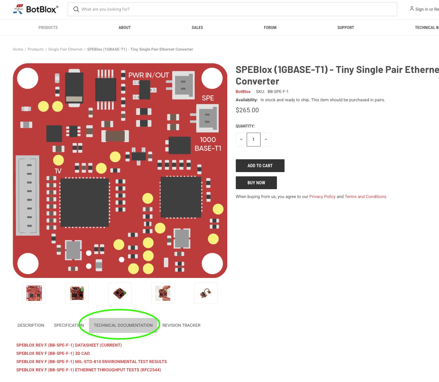

For future reference, environmental test results for all our hardware (Along with all other documentation) can be found by going to the “Technical Documentation” tab on the product page.
We’re transparent and public with all our test data.
Perfect! must’ve missed it in the Tech docs link. Thanks for all the support, we will keep you guys in the loop for further integration.
