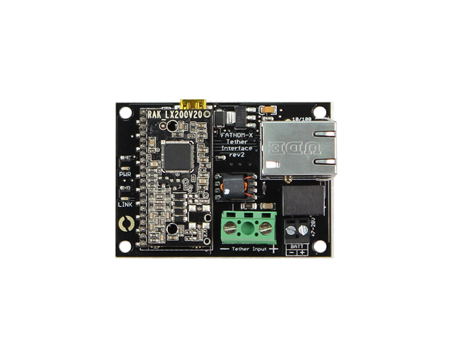

1 question, is there no 100Mbps version available which can reach a longer distance?
Unfortunately no, 100Mbps SPE has similar restrictions to 1Gbps SPE. You could try HomePlug or Gigabit home network. Both technologies that allow transmission over a single pair. It’s just not something we sell. You could try something like this
